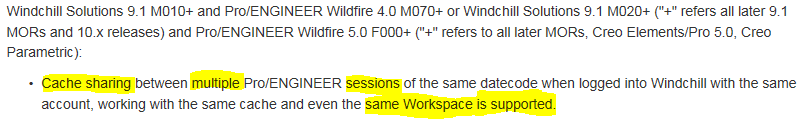

A node locked license will allow unlimited local sessions on that one computer.  On the other hand, a floating license will only allow a single session.  Starting additional sessions will pull additional floating licenses.  Borrowing a floating licenses makes it act like a node locked license for the duration of the borrowing period.
As others have noted, there are some limitations with when the same user can run multiple sessions of Creo while connected to the same cache.
From CS131176
