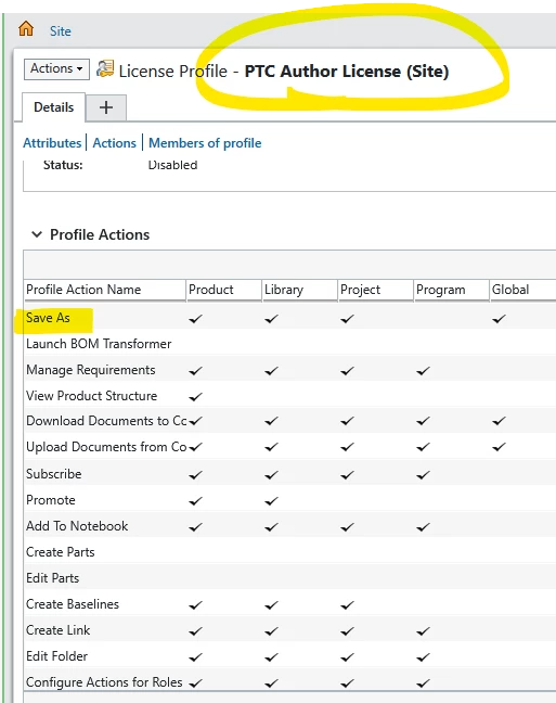

Save As Action ePLM License Model
In the legacy licensing model Base, Advanced, Premium, the Windchill Save As action was included in Windchill Base.
Which license does this action correspond to in the new ePLM licensing model? Standard Author? Design Engineering Lite? Design Engineering?
Thanks a lot
Christian
MarcoTosin
Apr 14, 2026 2:28 PM UTC
You can view the actions assigned to each license profile by going to Site --> Profile and then clicking the information icon
