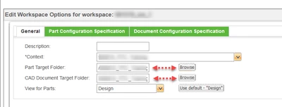

We use the save-as function all the time. The common practice is to download a master or reference model to a workspace and save a copy from there. During that process, the file location is set to the root folder of Windchill by default and the files have to be reassigned. We would like to have the new files location match the reference ones.
We have the preference management option "use location source object" set to yes. Unfortunately, it only works with the save as from commonspace, and not from workspace.

One possible solution - you could use workspace preferences to set the location for CAD/wtparts on upload. That way any file that is "new" from that workspace will go to that location.
From the workspace table, click the edit pencil, then set the folder location
