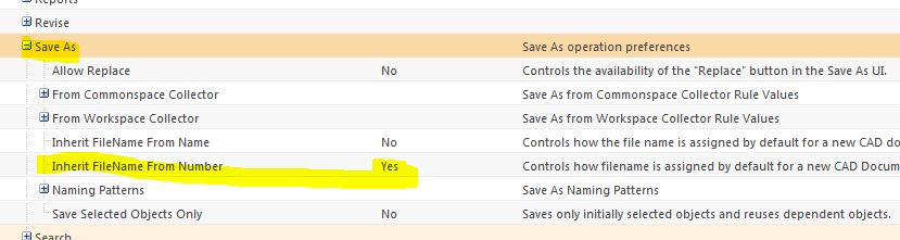

You should be able to set this in preferences by changing "Inherit FileName From Number" under "Save As" to yes. We are on Windchill PDMLink 10 M030 and have that set.

Thanks for reply, yes this I have also but I am reffering to the Name not FileName, something like "Inherit New Name from Number".
Nov 29, 2012 4:54 PM UTC
Sorry for he confusion, yeah, as far as I know there is no system switch to make the name field the same as number on a save-as. Like you stated, the OIR can do this for new objects, but save-as does not have the option. We have a similar issue with rename not having an option like I highlighted above for save-as for file name and number equality. The checkbox can be set in the "set new name" function within rename (to set file name = number), but there is no system switch to have that equality set as a system default.
