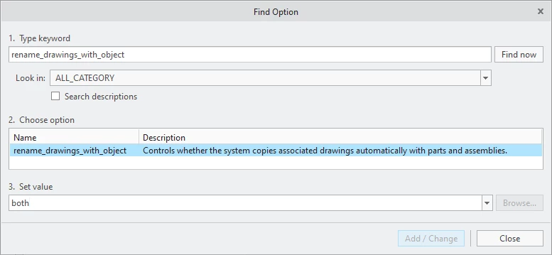

Take a look at the config option 'rename_drawing_with_object':
Apr 27, 2022 8:06 PM UTC
I've setted this option on "both" for Creo Stand Alone and linked with Windchill.
But it happens only with WC. So I don't think that this is
TomU
Apr 28, 2022 12:49 PM UTC
It works in standalone too, but the drawing must be present in the working directory and it must have the same name as the model.

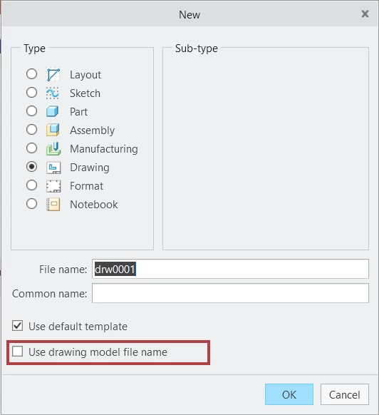

For information, in Creo 8 you now have the option to set the drawing name according to the CAD model automatically when creating a new drawing.
So the workflow would be to create the model first, and then create a new drawing when required using the checking the Use drawing model file name option highlighted below. The drawing will automatically have the same name as the model.
Yes, that true.
Anyway I start from the part model.
