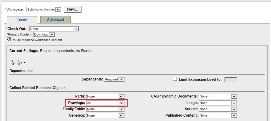

Now a follow up questions. By putting the assembly in workspace it brings all the parts along. Any way to pull all the drawings from those parts into workspace without putting each one in.
thanks
TomU
Mar 18, 2019 1:59 PM UTC
Definitely.  When adding the assembly to the workspace just set 'Drawings' to 'All' under the 'Collect Related Business Objects' section on the 'Add to Workspace' page.

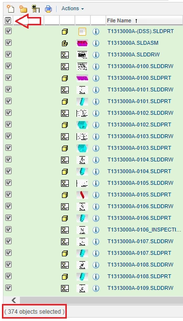

The other option is to go to the folder where these files are stored, select all of them (including the drawings), and then add them to the workspace that way.
