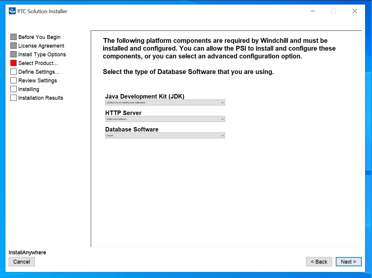

Hi there,
I am trying to install Windchill.
But when I start the installer via RDP on a computer with a 4k monitor, I get this:
Title, side bar and headings are quite readable.
But all input fields (text, dropdown, checkbox, etc. ) a tiny and not readable.
The text lines are only 5 pixels “tall”.
Is there a trick?

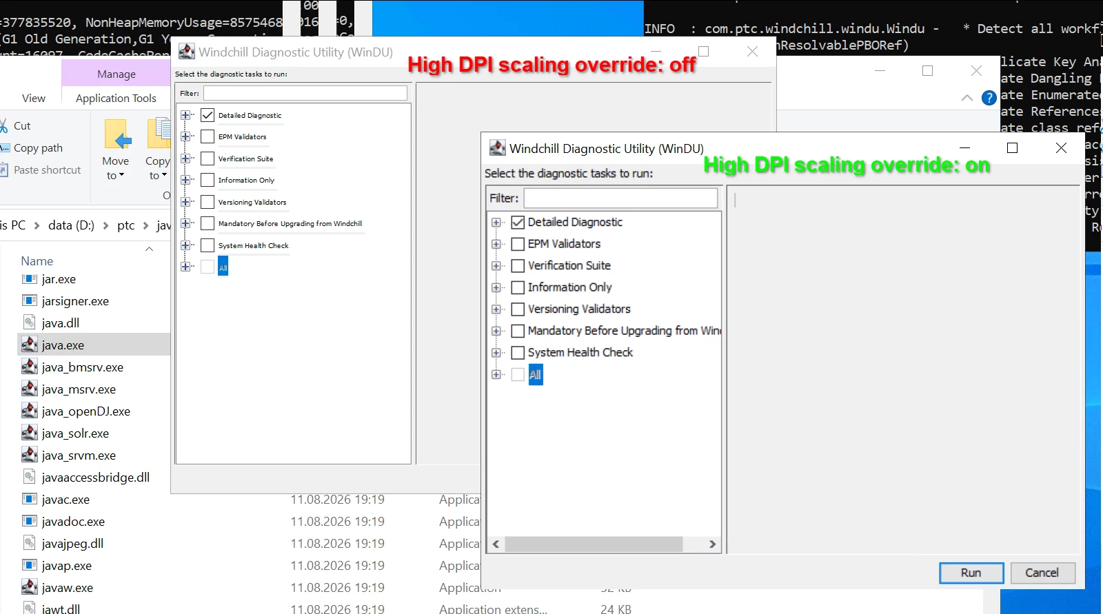

Mat16-PearlAuthor
Sep 8, 2026 8:40 AM UTC
Thanks, that did the trick.
tldr:
Find “javaw.exe” and change its “compatiblity settings”. Activate “high dpi scaling override” and choose “system (enhanced)”.
Mat16-PearlAuthor
Sep 10, 2026 8:19 AM UTC
For the record:
If You experience the same issue in WinDU and WinRU, which would be very likely, use the same trick for “java.exe”:
