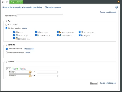

Is possible to search a dimension in 2D by this page in windchill?
Is possible to search a dimension in 3D by dimension 3D, in windchill too.

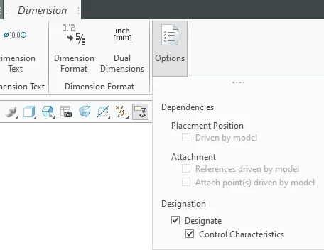

It is possible by creating a designated parameter in the drawing and a relation to link the designated parameter to the appropriate parameter.
Then you’d create a corresponding attribute in Windchill.
You could then search on the corresponding attribute.

I guess when you are speaking about the MBD Models, which has 3D dimensions in it. If you are checking in CAD data into the windchill, it's going to send metadata into the DB (like type, number, name etc.) and physical model files will go into the vault. Windchill Database will not have a details about your the geometry and it's MBD notes or dimensions.
That's why windchill will not have a control to index that information, That's the reason why it's not possible to search using 3D or 2D dimensions in windchill using search functionality.

I haven't done this myself, but I believe that if the dimension is designated as a control characteristic, there is a way to find it in Windchill.
