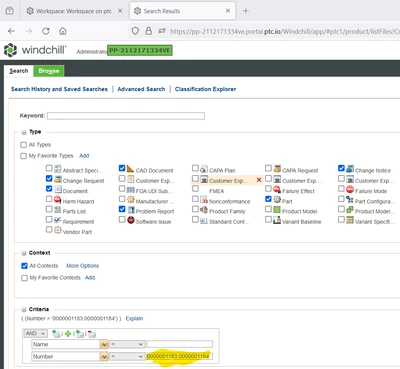

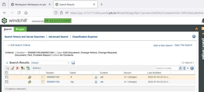

use semicolon in number field in advanced search :

If your system use a solr index search then you can use the semicolon only in the specific attribute filed, not in the key word column.
@Fadel has showed nice example how it works.

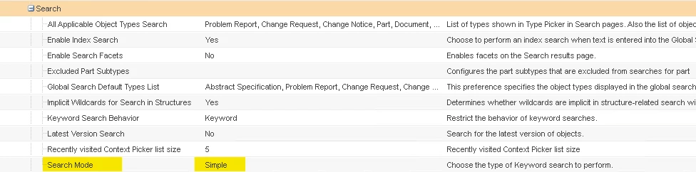

Aug 26, 2025 9:28 PM UTC

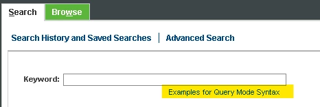

If you are using the keyword search with Solr (Windchill Index Search), then you need to switch your search mode preference from 'Simple' to 'Advanced' first.
Once you make that change, the keyword search behavior changes.  You can tell by the extra text underneath it.

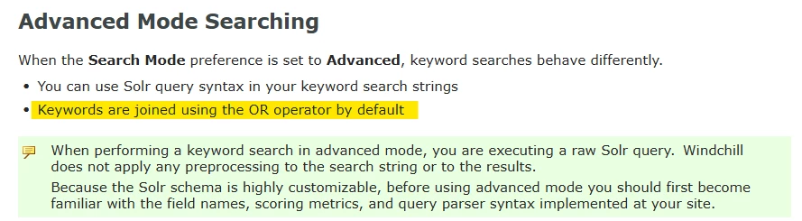

See this page in the help documentation for an explanation of the different options for advanced searching.
https://support.ptc.com/help/windchill/plus/r12.0.2.0/en/index.html#page/Windchill_Help_Center/LclSrchAdvancedSearchMode.html#wwID0EEH2O
Based on this statement from that page, a single space character should automatically be treated as 'OR'.  You can also use a comma with a space after it or the word 'OR' with a space before and after it.
