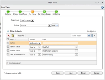

Feb 25, 2020 1:16 PM UTC
Our models are driven by Excel, and hundreds of parts will change/update when we make a change in Excel.
So the "change date" of all the parts will be (nearly) indentical, thus your first two suggestions will not work for us.
I thought I could create a new View, but the "Set Filters" only allows for all OR statements or all AND statements ("Match All").
I have the need for:
"Number Not Equal to MY_DRAWING_NUMBER"  AND ("Modified Status Equal to Modified" OR "Modified Status Equal to Modifications Uploaded" OR "Local Workspace status Equal to Modified locally")
Notice the mixture of AND and OR..
- sigh -

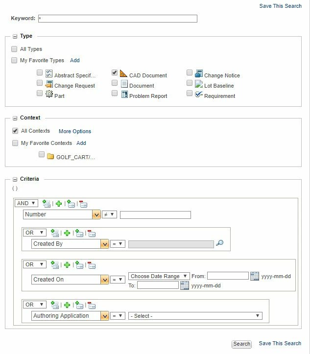

Another way I can think of is > creating a Saves Search which has ways to add AND / OR in the Criteria, I believe this can fulfill your use-case.
