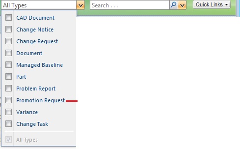

Nov 30, 2015 4:57 PM UTC
Set your search type to All Types, then in the search field enter 'eco*'.
Check the OIR for Promotion Requests to be sure of the naming convention.

Dec 1, 2015 12:02 PM UTC
Isn't it in the drop-down of the upper-right?

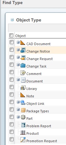

Or when you go to the Advanced Search and you select the Add next to the Type is it not there?
Dec 1, 2015 1:44 PM UTC
What version? On 10.0m040, I don't have all those options on the type menu. Is it a preference to show more types?
PDMLink 10.0m040 menu for Type
PDMLink 10.2m030 menu for Type
Both installs are OOTB and no mods done.

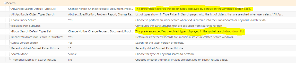

Dec 3, 2015 4:15 AM UTC
Ben Loosli‌,
The contents of this list is controlled by a preference.  Go to Site --> Utilities --> Preference Management --> Search.
Feb 19, 2016 11:06 PM UTC
Can't you set which object types you want to find within an Advanced Search?
Go into Advanced Search, then in the Type section deselect All, click Add, and then every primary object type in the system should be there listed in alphabetical order. Select Promotion Request.

I should have stated which Version of windchill I am using. those options in the drop box do not show up on my version.
I also had gone through my Utilities, Preference management, Search options and did not have the option to update those particular options.

You have to be Site admin for that first option.
