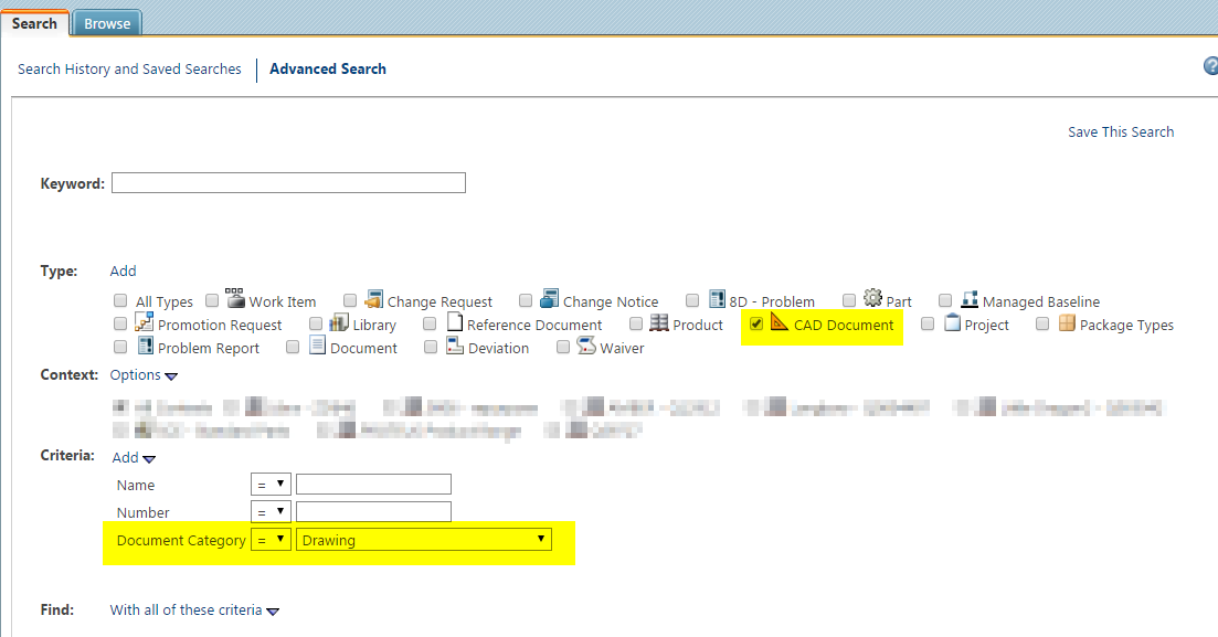

Searching drawing in windchill
Please let me know, how to search a drawing a drawing in windchill.
Is it possible to set a filter type for drawing in search.
Dec 10, 2014 10:12 AM UTC
for WC10
Search for type - CAD Document
Add criteria to search "Document Catagory" then set to Drawing
for WC10

Thank you.
