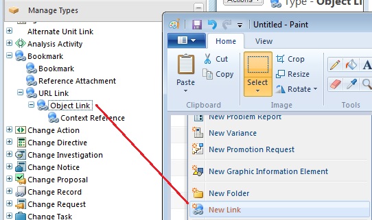

STEVEG21-Topaz IAuthor
Sep 25, 2015 8:11 PM UTC
Fantastic.  Thank you Lori.  Now I have to find the name of the type.
Sep 25, 2015 8:19 PM UTC
Is that the Object Link?
