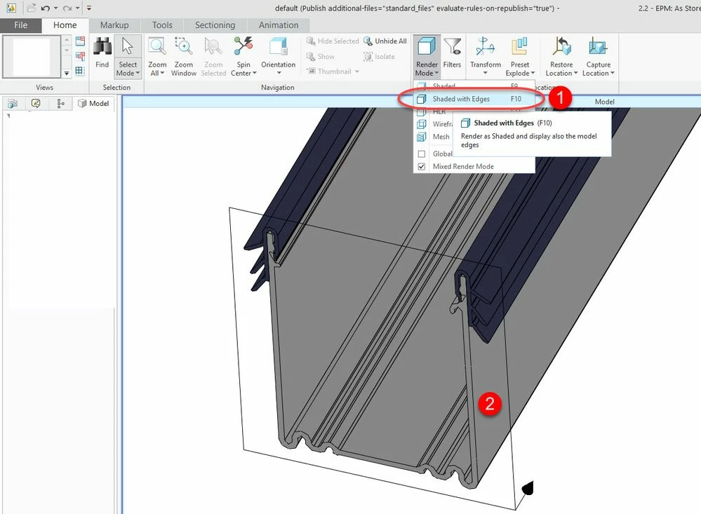

Hi Forum,
I created a section of a part in Creo View 4.1.
There are two problems with the section. Firstly, the section surface is completely seamless, although the section comprises several parts. Therefore, the boundaries between the several parts should be visible on the section surface, but they are not.
Secondly, the section surface is simply white/monochrome -- however, it should be hatched.

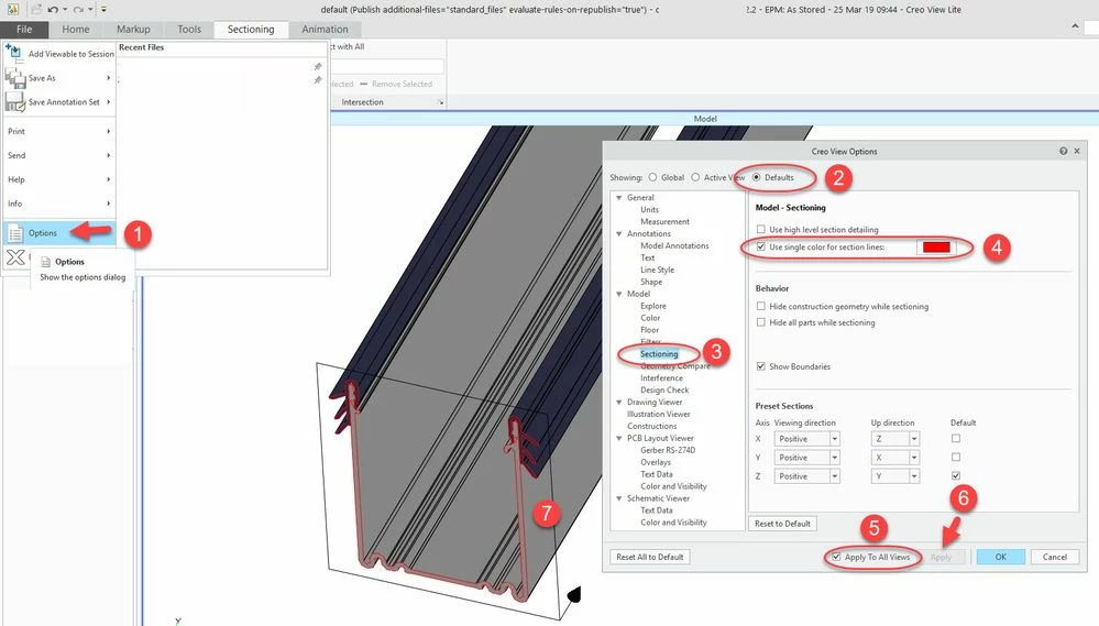

On the Home Tab, if you change the Display>Render Mode to Shaded with Edges the edges of the cross section should show up. If desired, you can change the section color in the options menu.
I have not seen a way to show cross sections as hatched.
Creo View Cross Sections Shaded w Edges.jpgCreo View Cross Sections Change Color.jpg

Thank you. I just saw that the section, other than I thought, does not include several parts.
Therefore Creo Vew had rendered the section correctly.
Nevertheless, thank you also for your tip for better visibility of the edges.
