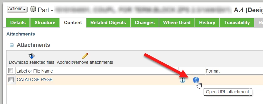

Recently I've noticed one of our regions is adding (on the Content Tab) URLs to outside websites.  Since we are a cloud based system, I am extremely concerned about that site being an opening into our system.  Which makes me wonder about a couple questions.
1. Has anyone experienced anything like a security breach via an external URL link?
2. What is the easiest way to restrict people from adding URLs to WTParts or WTDocuments?

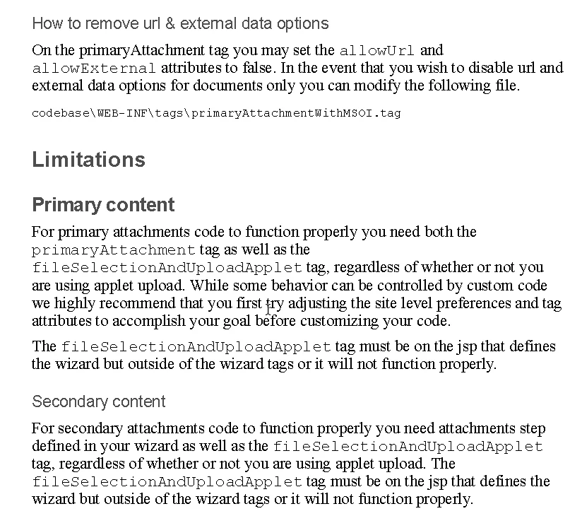

I am not sure if this will allow you to do it but did you try creating a rights policy for URLDefinition?  It's a sub-type of WTObject.
JHall2-ExplorerAuthor
2-Explorer
Jul 26, 2019 9:26 PM UTC
@STEVEG   I discovered that I can shut down all URLs in Windchill that point to external sites.  On Page 315 of Windchill Customization Guide (11.0 M030 June 2017 Document Version 11.03.01) I discovered the following.
It looks like it will do what I'm thinking, however I'm not quite sure just yet I want to turn them off completely.   According to the PTC tech I talked to, any previous URLs would simply not work if I did this. I'm just not sure what sort of security hazard external links might be.
