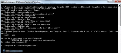

Self Signed wildcard certificate using keytool
Hello All,
I would like to know how we can generate the Self Signed Wildcard certificate using the keytool utility? If not possible through keytool, is there any other way using which we can generate the Self signed Wildcard certificate?

Have you try this article? https://www.sslshopper.com/article-how-to-create-a-self-signed-certificate-using-java-keytool.html

Hi @HelesicPetr
Thanks for your reply.
From the shared Article and as per below snapshot, do we need to enter domain details in First and Last name?
e.g., CN=*.abc.com
Avinash
HelesicPetr
Apr 13, 2023 12:51 PM UTC
If you generate certificate for some address you need to define full address.
So yes you also need to use domain address
