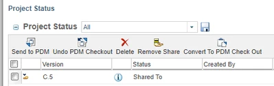

And the project status table is also quite useful, I think. You can toggle share/checkout directly from there.

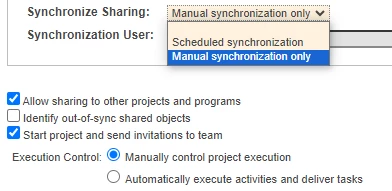

You can have a project set up to do automatic syncs and updates. There's a preference in wt.properties that deteremines the schedule of the sync operations. https://support.ptc.com/help/windchill/r12.1.2.0/en/index.html#page/Windchill_Help_Center/interop/InteropShareAutoSynch.html

  • "Add to Project" with PDM Checkout option is the same as "Add to Workspace" and "Checkout". Except here, you're checking out the file to the Project context for subsequent editing and the file is meanwhile locked for editing in the product.
  • Once shared with PDM Checkout, the iterations at that revision level of the shared file are maintained within the project context separately and ONLY live there.
  • "Send to PDM" is a project to product check-in operation so the latest iteration of the project file becomes the next iteration of the product file. At that point, you have a version history in the product AND a version history at a pericular share action in the project.
As long as wrap your head around the actions, there aren't problems with this flow. It gets tricky with updating the project. Are you doing manual updates or scheduled syncs?

It's a Manual & but if we maintain in a Project Management Folder i can't do ECN or ECR, Promotion request, & many more.
Revisions: A new revision of a file in a product context is not automatically shared to a project. But both or same link right. Then why had a this much complicate.
Renames: If that user have a permission for rename, move and all access means it's update in Project Management data also.
I want more explanation for manual updates or scheduled syncs
