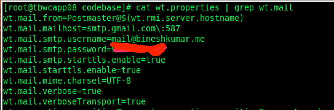

I am using google apps email with test system, here are my settings.
I have enabled wt.mail.verboseTransport verbose and here is the  snippet from the logs.

Apr 16, 2016 12:30 AM UTC
I suspect a syntax error in the wt.properties, it is firing the connection without TLS. If I comment my TLS enable line in wt.properties I get the same error as yours. Stating 10.1 TLS is enabled, so you are good.

I know you would have done that, but scan through wt.properties again wt.mail properties
