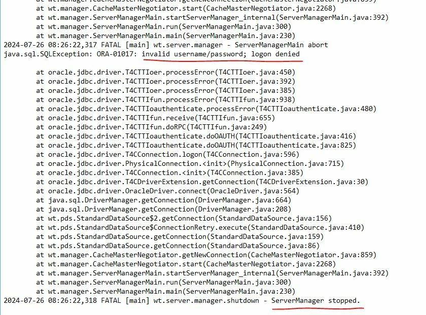

Server Manager hangs on startup and Method Server fails to launch in Windchill PDMLink
Version: Windchill 11.0

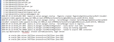

Use Case: Windchill in our customer; methode server cann't start with error: "ORA-01017: invalid username/password; logon denied".
Description:
We are using Windchill PDMLink Version 11.0 M030/Oracle 11
  1. Since last week, CAD Creo users cannot/slowresponse access to the server. First I was check via status server >> average response time (red).
  2. Then, I restarted Windchill services (WC shell ; Stop >> Start).
  3. But in this point, windchill methode server cann't start back to stopped status in services.msc windows. Users can not acces anymore (Service unavailable).
  4. We checked  log,result at screenshot below :

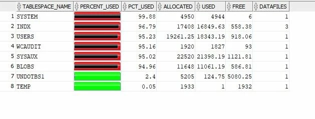

  • Next ,we checked the DB server ( we use separate server for DB Oracle).
Storage almost full,then we extended storage tablespace.
Then we try again to start the Windchill,but unfortunelly it stills no started.
Do you know what happen? Server manager likes hangUp! methodserver fails to start.
Information in log :

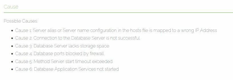

We follow the resolution CS125275 below,but still not works:
Do you have any others ideas/suggestions?

Hi @dnpermadhy-2
If the log file says wrong user name or password, I would really check if the user name and password is correct in  the db.properties.
Yes the password is encrypted but I would test the login to the DB with the user that is used for Windchill db connection.
For example, the password could expired in DB based on policies or something else.
Also reset the password in db.propertioes that works with login in a sqlplus
PetrH

Hi Vladimir ,
Problem still not resolved(methode server nor starting), I have followed the steps in the article CS50219.
Does anyone have another solution or Best Practise Windchill PDMLink with Oracle DB?
