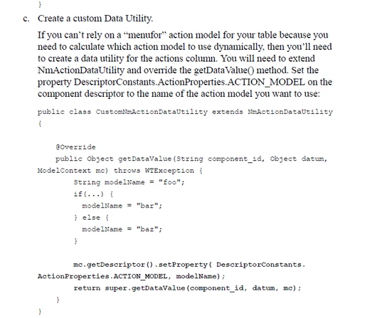

Hi Anthony,
Can you please give a complete dataUtility example ?
Thank you in advance,
Hicham
HelesicPetr
Mar 17, 2023 1:04 PM UTC
Hi @HL_10554529
Check a customization guide Link to guide 12.1.2.0.
