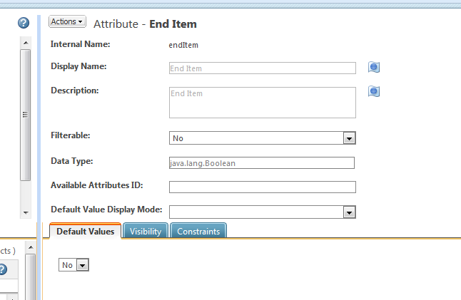

You need to go to Type and Attribute manager, edit the type, then select the attribute. See panel on right
Mar 1, 2017 4:22 PM UTC
Setting a default value for the End Item does not work.
