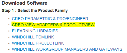

TomU
Apr 2, 2015 12:06 PM UTC
No, it comes with Windchill, although it's in a separate area on the downloads page.

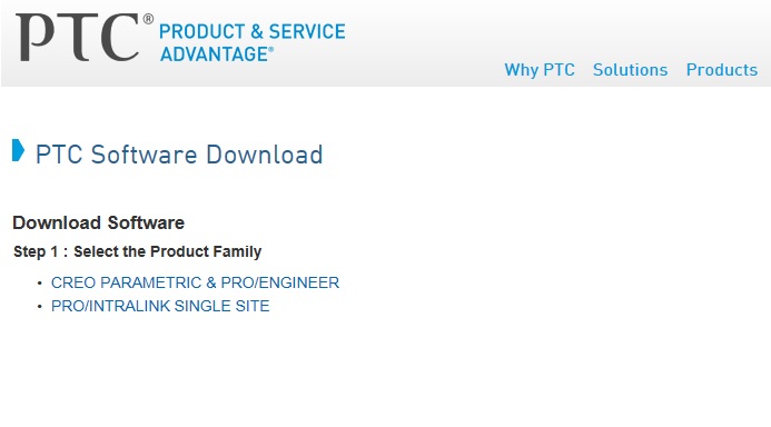

2-Explorer
Apr 7, 2015 5:37 AM UTC
In my download center View Adapter is not available. How can I add it?
