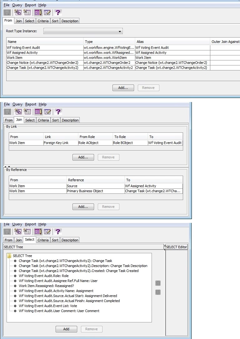

I am working on a report to show each line of the "Tasks for Change Process" table with the dates and times.  Our workflow has a Rework routing option.  If a user sends the workflow back on a Rework then for every Rework there is another line in that table.
The problem is each task in the report shows the date of the last Rework.  I.e.: If there are 3 Rework lines then all 3 lines in my report shows the same date and time of the last Rework.
Is there any way to have the tasks show the correct date and time for each of the instance?
