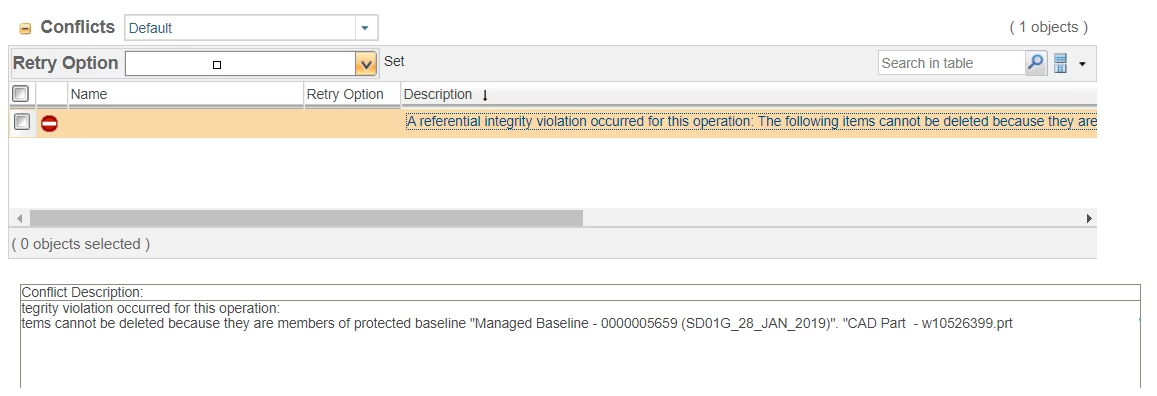

Hello everyone,
while deleting a CAD from "IN-REVISION" state to previous released, i am facing this error. see attached.
could you please help?
Sandy

Hi @Sandy7
You can not delete object that is part of a Baseline.
Delete the baseline that is mentioned in the error and you can delete the revision.

hi @HelesicPetr ,
how can i find that baseline and delete it.?

Hi @Sandy7
In the search ? Advanced Search?
