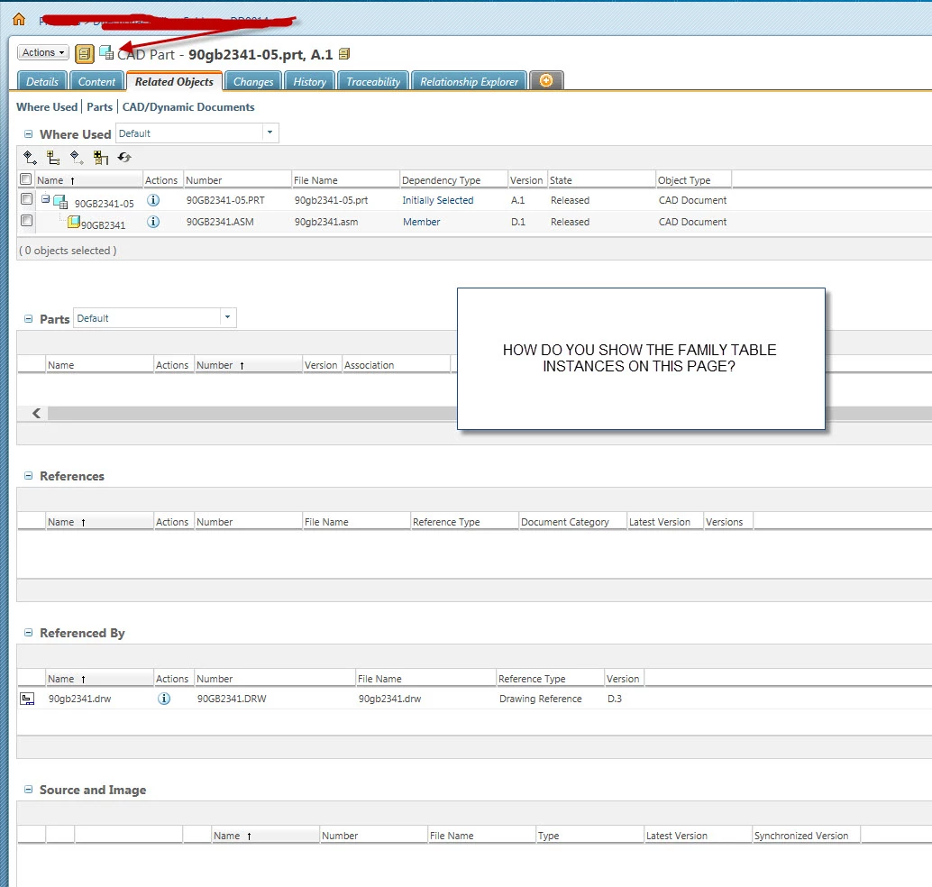

I have an family table part. I search on the p/n. Go to the "view information" page, select "related objects" and dont see the instances listed. I am sure you have to create a custom view?. So how do you create the view and where? We are using WC 10.2 M020. I have attached a screen shot of the page I think it should appear on. If its located someplace else let me know.

Create customized view and display Related Objects ->Family
Feb 17, 2015 10:09 PM UTC
Create a new tab try to add that way and train users to use that tab
instead. To be clear I'm also saying try to add tables to the new tab which
you already see on your screenshot.
If I'm understanding correctly your question.
Let us know with updated screenshot what works?

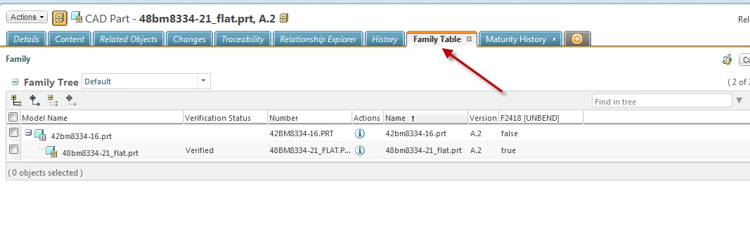

Thanks David and Ushamirsky for the fast response. Solution is to create a new tab from the customize button on the right side. Then select “related objects” and “family”. As an added hint if you have your wcadmin user set the tab to “public” everyone will see the new table when then search on a family table object.
