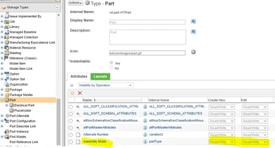

Can anyone provide an example for how the Assembly Mode attribute can be set as mandatory/optional and how to decide where the attributes are displayed in PDM Essentials?

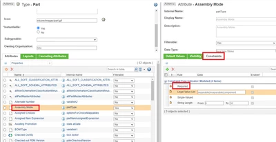

Below is what I see in the Types and Attributes Utility that imply I should see the Assembly Mode as an attribute on a part or assembly but I do not see it.

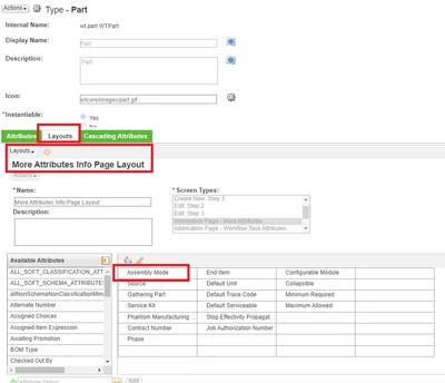

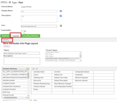

The Layout Tab is a right place to configure where the attribute should be shown.

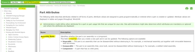

Also the Assembly Mode is always required.

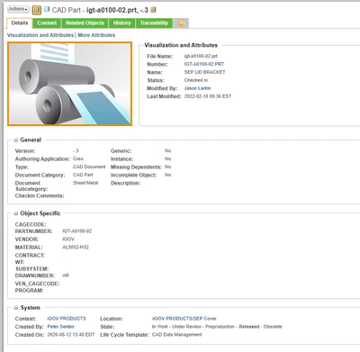

Thanks for the info confirming how to manage the attribute, but can you tell me where the user would see it?
I cannot see the attribute on recently created parts. Example below and pardon, I should have included this in the original post.

In the tab Layout is a menu laout where are several types places where are the attributes shown.
Detail page, Creation wizard page, Structure page atc...
Each option has defined value in a screen type window
For EPMDocument creation wizard can be set to show your attributes in the creation wizard. (only in html creation wizard)
