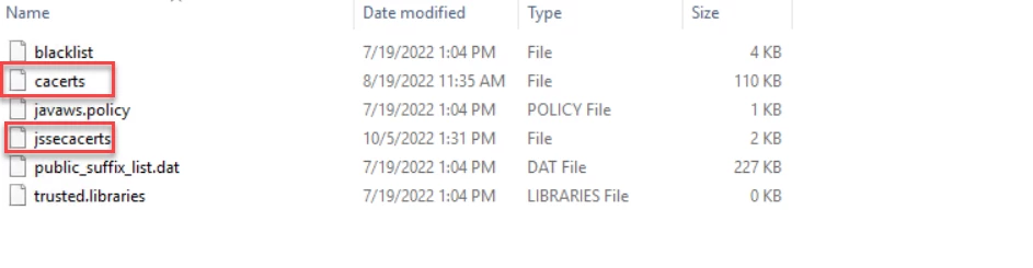

Nov 17, 2022 10:07 PM UTC
Hello ,
There are multiple reasons for SITE NOT RESPONDING error. However, looks like it is coming as soon as you enable SSL.
In order to resolve this, please add a security certificate to Java (JRE) cacerts or jssecacerts file.
The very easiest way to import the certificate into these files is by using keytool https://keystore-explorer.org/
Once you do that, restart apache and Windchill. This error will go away.
Regards
Ajit
