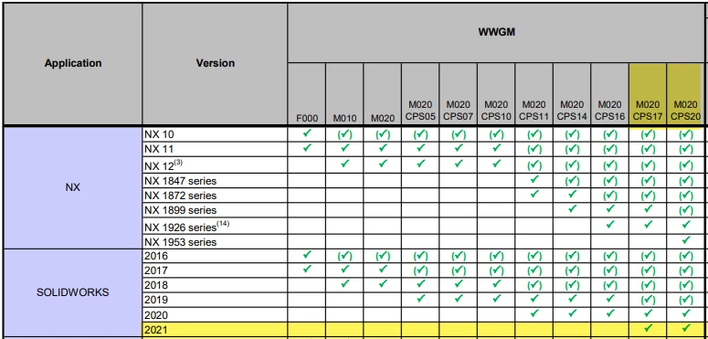

Looking for some clarification on the Windchill CAD Integration matrix regarding Solidworks 2021.
As shown below, SW2021 is supported for CPS17 and CPS20. Does this mean it is not supported in CPS18 or CPS19.
We are currently on CPS19 and after consecutive defects in CPS16-CPS18, I'm a bit reluctant to install CPS20 unless its the only way to have proper support for Solidworks 2021.

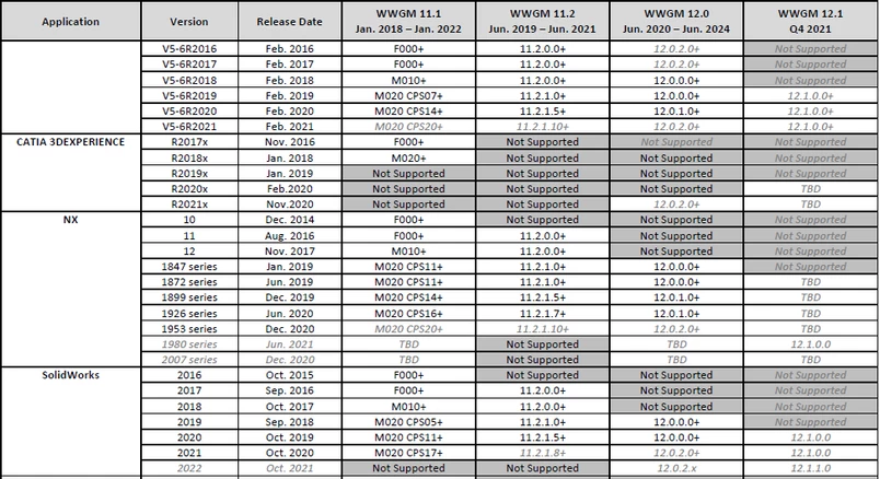

October 1, 2021
Scott,
I see this in the Windchill Future CAD-Integration Support Summary
Revision 1.9
June 3, 2021
Different documents that do not agree. Not the first time I have seen this with PTC documentation.
ScottMorris
October 4, 2021
oh man, i forgot that WGM releases asynchronously these days and not with CPS any more. that leads me to believe Solidworks 2021 is fully supported stating at CPS17 and possibly has an asynchronous release of WGM ~CPS20. i miss just pairing up WGM with the CPS.
