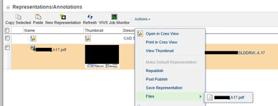

I doubt that there is a simple solution for this. However, I know of a workaround that may be useful for you.
We have SolidWorks as our primary CAD package and have PDFs as our deliverables. When we first implemented Windchill, we used Wincom utilities to mass upload historic drawings (including scans of old paper drawings). We have been using the same utilities ever since for occasional manual uploads when SolidWorks misbehaves and refuses produce an acceptable PDF.
These utilities create a proper representation that can be opened in Creo View.
It should be possible to create something similar to delete/create a new representation with a new PDF filename automatically after publishing.
Here's an example of the utility use:
windchill net.wincomco.windchill.wincom.reputils.impl.commands.WComRepUpdate -oid VR:wt.epm.EPMDocument:123456789 -default true -file "C:\temp\123456_A17.pdf" -name 123456_A17.pdf ....

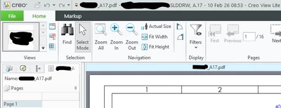

Resulting representation:
