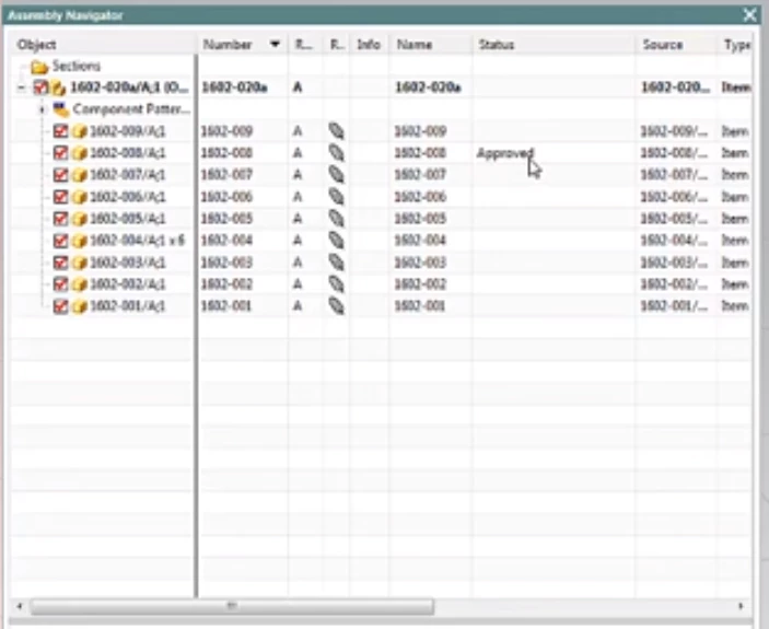

We have recently integrated SolidWorks with PTC Windchill. Previously, I have used, NX w/Teamcenter and on the feature tree there was columns for the Revision, State (Released,Obsolete), etc.  Do you know if SolidWorks has anything similar to that?  See attached screenshot for an example.

I know its in WGM, but it would be really helpful in SW, I think this is a big flaw on their part.  I am pretty sure the other CAD software has this feature.  I know NX and Solid Edge do, and I believe Creo does as well.

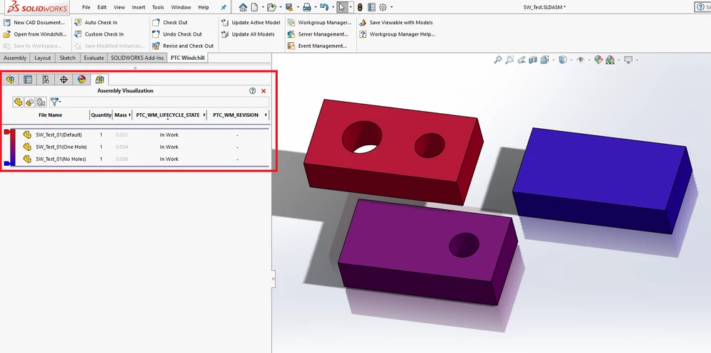

Yes, a quick search shows this is possible via "Assembly Visualization".  Just add additional columns for whatever attributes you're interested in.

How did you get those columns to show up?  When I "Add Columns" is only adds Total Weight, Mass, Density, Volume, is does not give me an option for any other columns.
