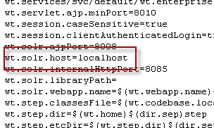

Great news - got it working (perfectly, and instant).
Was just missing this property value (property is present but blank after install). Thanks to Serge Caron for the tip.
