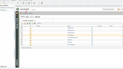

SQL Database
Can help to point to the file name which stores the database table for PDM

It is complicated. Each type of object has own table.
WTPart, EPMDocument, Product, Library, Folders.
There is not just one table that shows you content of specific product.
You need to observe the sql selects in  the articles and you may find the links between tables and other consequences.
for example
WTPart table contains reference to a context and context is a product or a library
PS: select * from WindchillDB.PDMLinkProduct shows the product information

thanks for the reply. I am looking for a specific table on SQL server which stores the details for the each product created. Please refer image below.
for example
