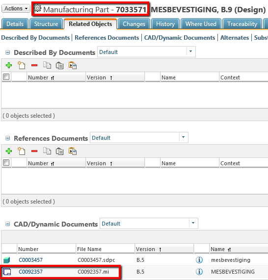

Does somebody know what the link in SQL is between a 2D drawing and a WTPart? I can't find it.
I tried this:
select epmdocumentmaster.documentnumber, wtpartnumber
from epmbuildrule,wtpart,wtpartmaster,epmdocument,epmdocumentmaster where
epmdocument.branchiditerationinfo = epmbuildrule.branchida3a5 and
epmdocument.latestiterationinfo='1' and
epmdocumentmaster.ida3a6 = epmdocument.ida3masterreference and
wtpart.branchiditerationinfo = epmbuildrule.branchida3b5 and
wtpart.latestiterationinfo='1' and
wtpartmaster.ida2a2 = wtpart.ida3masterreference and
wtpartmaster.wtpartnumber='7033571';
With this I get an empty result, so something is wrong.
Thanks in advance

Use EPMReferenceLink
May 26, 2016 1:53 PM UTC
If the relationship shows as calculated, there is no direct relationship between a wtpart and a drawing. You will have to link it through the model.
EPMDocument -EPMDocument1(drawing)
WTPart-EPMDocument
Pardeep
May 26, 2016 2:15 PM UTC
So then what is the link between a 3d model and a 2D drawing?
This I also don't know.
Thanks again
2-Explorer
May 26, 2016 4:07 PM UTC
