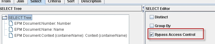

I have a Query Builder report which will show this information but since it goes through access control it won't show you anything for files you can't access. The View as SQL in Query Builder gives me a place to start but only gives numbers not the context name. Could anyone give me some hints on the correct SQL or a way to run the Query Builder report as a user who can view everything without giving the users access to that username and password.

"Bypass Access Control" as shown should be all that is needed. It will allow the report to list the object and its context without allowing users to drill down if they don't otherwise have access.
