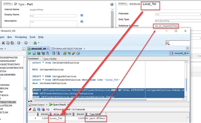

Hi
Where can I find the actual attribute names of the standard attributes (PTC_BLN..../STR... fields)?
Is there any table (in the Database) that contains the Standard attributes field name with the Part Type and attributes name
See attached picture
Thank you,
Ilan.M

Hi @Ilan_Mor
Basically name of standard attributes stored in LWCFlexAttDefinition database table. please refer below query which give name of standard attribute and related type.
Example:
Note: I have created query for specific attribute:
SELECT LWCFlexAttDefinition.IDA3A5,LWCFlexAttDefinition.NAME AS"lOCAL ATTRIBUTE",lwctypedefinition.IDA2A2,lwctypedefinition.NAME AS"Type NAME"
FROM LWCFlexAttDefinition,lwctypedefinition
WHERE LWCFlexAttDefinition.IDA3A5=lwctypedefinition.IDA2A2
AND LWCFlexAttDefinition.NAME LIKE 'Local_Tst'
Screenshot:
Hope this helps to you.
