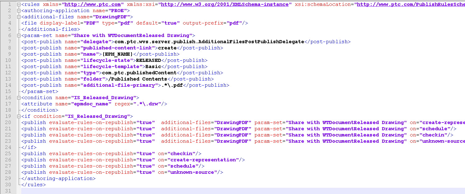

What you can do is create a publishing rule to publish drawings to pdf files and models to step and upload them as a wtdocument and build published content link  between the original epm documents and published files. Even though this sounds complicated the configuration is easy.
From visualization configuration in utilities, create a configuration and upload the publish rule. Publish rule looks something like the below. Below is a publish rule which I have to publish the drawings to pdf, then the delegate creates a document of the type - com.ptc.PublishedContent(we have this subtype created), the name of the file is same as drawing name, lifecycle template basic, lifecycle state released, and the file is created in a folder called published contents(again you have  to create a folder by this name) .

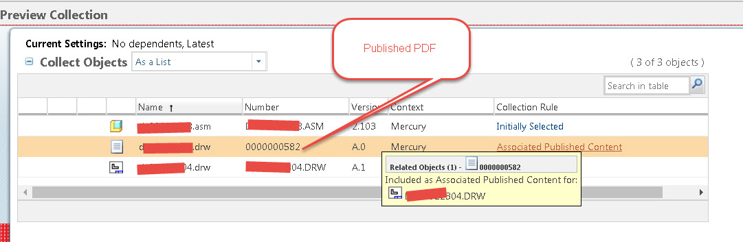

If you republish a drawing with this publish rule, it will create a pdf as wtdocument. For the packages, if you have the collector set to collect the published content, it will collect the pdfs and steps too.
Hope this helps.I have attached the publish rule as well
