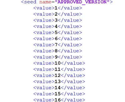

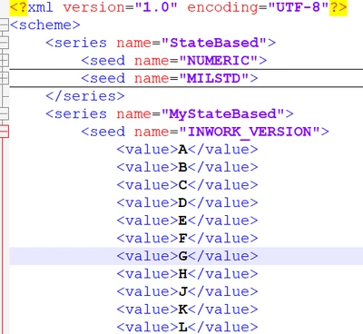

State based versioning scheme doesn't apply when manual set state done from approved to released
I have created a custom Versioning Scheme which should work with State Change from Approved -> Released ( i.e A.1 (Approved) will change to 1.1 (Released) State change either manually or when triggered in custom Workflow)
Has anyone encountered such issues, as this custom versioning is working for Object Revise action but not for Set State action / in Workflow State Change
Your support is appreciated. Thank you.

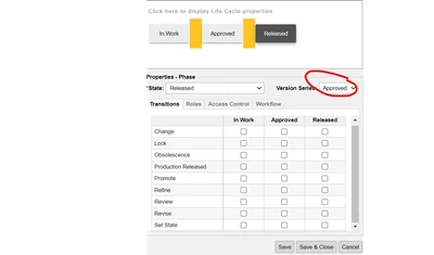

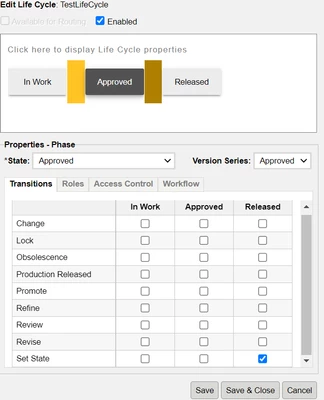

Lifecycle Transition:
where highlighted series is my Custom versioning Series name
joe_morton
May 8, 2023 6:49 PM UTC
You can create a workflow to trigger when the object reaches the Released state. Put the necessary additional steps in that workflow. That way, whether the objects is promoted or you use a set state, the secondary workflow will be triggered and the same steps will be performed for either case.

HelesicPetr
May 3, 2023 5:59 PM UTC
Hello @RB_10356553
The versioning schema is change only during Revise action.
Set state do not change it also Promotion do not change it.
You can set autorevision during Promotions request that the object is autorevised and then the versioning schema is changed.
