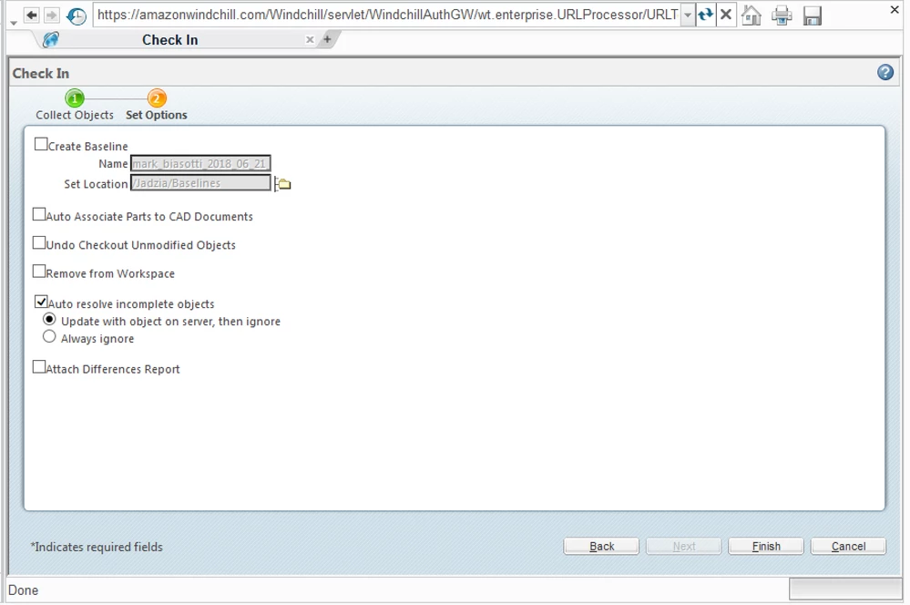

Jun 21, 2018 2:03 PM UTC
I DO NOT get this option on my windchill? (see attached image)

Jan 18, 2019 3:53 AM UTC
I don't have the option either. Did you ever figure this out?
