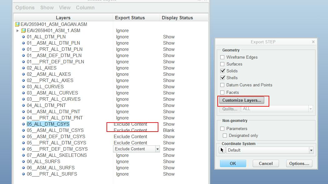

Hello,  this is about a problem I am facing when exporting a assembly as a STEP through my creo 3.0 and opening g it again in creo it shows a number of coordinate systems. how to import that STEP assembly without a bunch of CYS.

Hello Leopold
Can we customize this CSYS export wile saving as .stp file ?
or try by modifying the option "Step_out_suppl_geom" config.pro file ,refer below image

Hello Gagan,
I’m not sure about the Csys.
About geomtrie, have a look at the following lines extracted from working code:
     GeometryFlags flags = pfcExport.GeometryFlags_Create();
                flags.SetAsSolids ( true );
              //flags.SetAsSurfaces(true);
              //flags.SetAsQuilts(true);
//flags.SetAsWireframe(true);
inSession.IsConfigurationSupported(ExportType.EXPORT_STEP, AssemblyConfiguration.EXPORT_ASM_ASSEMBLY_PARTS)
step_instrs = pfcExport.STEP3DExportInstructions_Create( AssemblyConfiguration.EXPORT_ASM_FLAT_FILE , flags );
model.Export(path, step_instrs);
i also found method:
pfcExport.LayerExportOptions_Create(); ///but I never used it. -- think you should give it a try.
