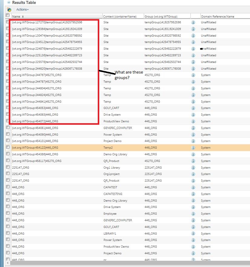

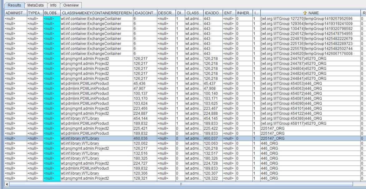

Experts, I was working on a code for fetching WTGroups and I saw some strange values being returned by the code. On checking the DB I saw weird group names in the database as well. These groups are not present in the UI. Any idea what these are? I also wrote a query builder report to query all WTGroups. It also returns the same.ScreenShot035.jpgScreenShot036.jpg

These are deleted groups. When a group is deleted from Windchill, most of the DB entries related to the group are deleted. However, Windchill keeps the entry in the WTGroup table, but makes two modifications to it. First, the name of the group is updated to be '{wt.org.WTGroup:<idA2A2>}<Name>'. Then, the value of the 'disabled' column is set to 1. The same is also done when users and orgs are deleted.
Whenever Windchill does any query for users/groups/orgs, the query always includes the predicate 'disabled=0', so that only valid groups are returned. If you want your code to ignore these groups, then you should modify it to only query for groups with a value of 0 in the disabled column.

To avoid disabled groups in your results , you can append following search condition to QuerySpec in your customization:
qs.appendWhere(new SearchCondition(WTGroup.class, WTGroup.DISABLED,SearchCondition.IS_FALSE )
