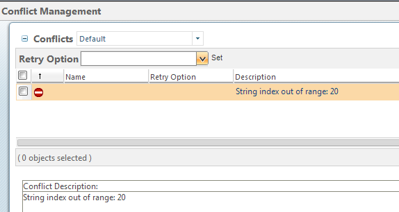

String index out of range: 20
When I try to revise a family table CAD parts, I get an error - "String index out of range: 20"
Does anybody have any idea why this error and how to fix this?
Mar 10, 2017 9:38 AM UTC
The issue was there was a html file attached to the generic that caused this issue.
After removing the attachment we were able to revise.
Mar 3, 2017 10:38 AM UTC
Can you please provide the server side error message in the MethodServer.log
There should be more info about what went wrong.
Mar 3, 2017 11:07 AM UTC
Unfortunately I don't have access to the logs
