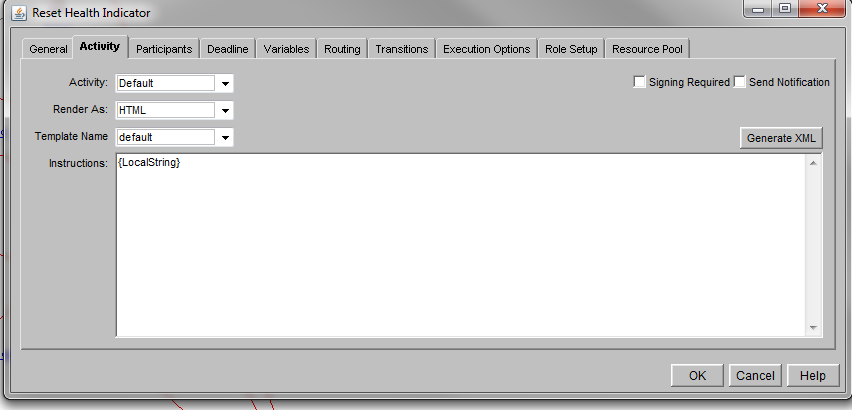

Oct 9, 2015 2:53 AM UTC
I've added a variable in curly braces into my instructions tab of an activity (a global workflow variable) but all it comes out with is that exactly as it is inputted.
ie {TestDebugString}
So is there anything special I need to do to make this bit work
Dynamic Activity Instructions
Add your String variable to the activity task instructions. Enclose the variable in curly braces.
{task1Instructions}

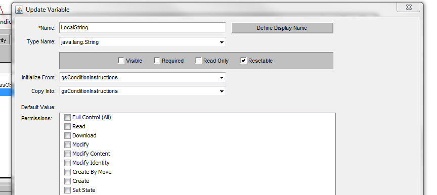

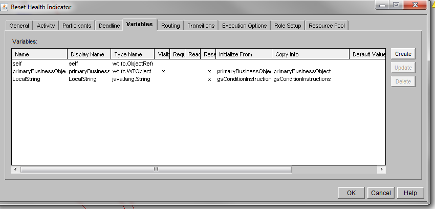

Oct 9, 2015 4:17 AM UTC
I've found out how to do this. You cannot use a global variable and expect it to work. I created a local variable in the activity and used the initialize from the global variable. Then if you place the local variable into the instructions tab in curly braces it works.
