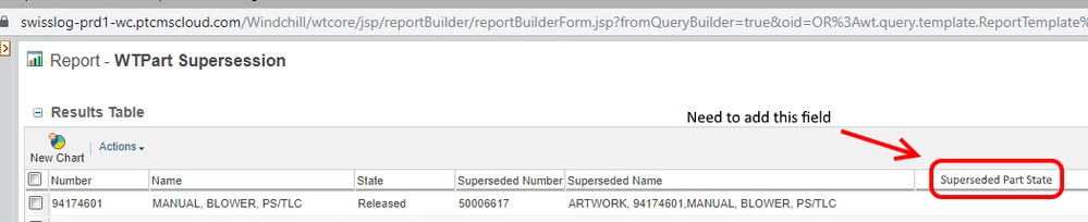

I'm a novice Report writer, but I'm giving it a whirl.  I've written a small report to return all parts that have been Superseded in Windchill.  I can get that, and the State of the WTPart that was the result of the super-session.  What I can't seem to collect is the state of the Superseded part?  Strange to me that I can't seem to collect both. Every time I add a second lifecycle to the report, I get duplicates and an incorrect result. I've Photoshopped what I'm looking for and attached the QML.  Anyone got any ideas?  Thanks in Advance.

@Marco_Tosin   Thanks! I'm looking through those reports, but I'm not seeing yet what I need.
Here is my QML  I forgot to attach it.

we don't use superseded parts so I can't look at your report, but I suggest to look at some of BOM reports in the document.
There you can see how to use many times the same object type in a report (for example Parent and Child WTPart in a BOM).
In that way you can extract the state from each of the types
