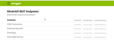

Hi all,
I know of the Swagger service at <server>/Windchill/netmarkets/jsp/restapi/ , and it works well to experiment with the REST API at <server>/Windchill/servlet/rest/structure/objects
Is there also an equivalent Swagger service for the Odata API at <server>/Windchill/servlet/odata/ ?

There are ways to describe the OData API with a Swagger definition. In fact this is even used in the WRS documentation browser, where the documentation on domain service level is rendered with the Swagger doc pages.  If you pay close attention you will even see that tehre is a URL in WIndchill that converts the OData to a Swagger/OpenAPI v2 service description.
This resource link (https://<server>/Windchill/netmarkets/html/wrs/odata-to-swagger.jsp?v=2&d=CADDocumentMgmt can also be used separately and the result will be the Swagger service description of the corresponding OData Domain and version in JSON format.
The generated OIpenAPIv2 service description has minor issues:
  1. it uses operationIds which are not unique. According to the spec operationIds are optional so you can fix it by removing them altogether.
  2. it doesn't include the name attribute for requestBody input params. According to the spec these are required but will be ignored. You can fix it by adding any name e.g. 'body' in the generated json.

We have 11.0 M030 CPS18 but navidating to the URL https://<server>/Windchill/netmarkets/html/wrs/doc.html
I get the results below.
With Rest services Help I am able to get the Swagger documentation
https://<server>/Windchill/netmarkets/jsp/restapi/index.html#!/Objects/findObjects
Any reason why the ODATA swagger does not exist/ open?

Aug 12, 2021 12:05 PM UTC
I did not install CPS18 myself, but I did read the installation instructions and they seemed more complex than normal. And I do remember seeing the same {{domain.page}} display as you. Then I notified our admin and a short while later it was working correctly.
