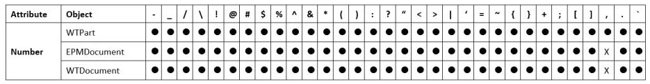

@BenLoosli, the picture shows searching for an attribute value, not a file name.  Question marks in a (string) attribute values are perfectly valid.  Finding those with a database query is simple but may not be possible from the Windchill interface.
TomU
Jan 2, 2025 9:37 PM UTC
Looking at the help documentation, ALL of these special characters (shown with a black circle) are valid for use in the Number attribute and therefore should be searchable from the Windchill interface:
