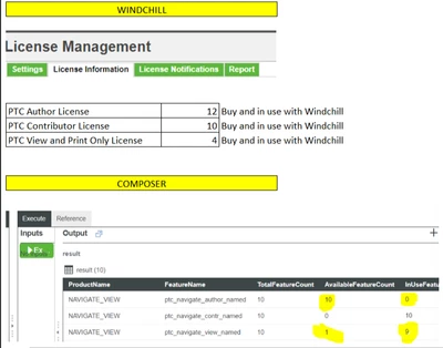

I have bought licenses : 12 PTC Author, 10 PTC Contribute and 4 PTC View.
However, on the Composer (Navigate) side, they are only : 10 PTC Author, 10 PTC Contribute and 10 PTC view
questions:
1. How can I synchronize Windchill with Composer (Navigate) to have a good number of licenses?
2. On the Composer side (Navigate) I cannot assign any license even though it indicates 10 as available.
3. On the Composer side (Navigate): Is it necessary that the ptc_navigate_author licenses be assigned to a group of licenses, for example ptc_navigate_view or ptc_navigate_contr?
Thanks for your help, I am new to Windchill and Composer (Navigate)
