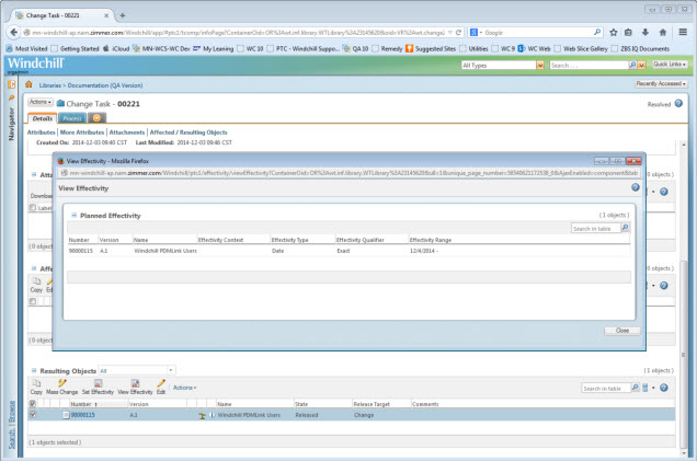

Anyone have any luck with using Effective date on WTDocument in 10.1 M040?
I would like to have the workflow sync on the Effective date from the Change Task within the CN.
"Objects that are effectivity-managed include parts, documents..."
"Effectivity is the planned date, lot, or serial number at which old versions of the object are replaced with new versions in production. You can make changes to planned effectivity settings from a change notice or a change task. When the change notice has been approved, the planned effectivities get copied over as actual effectivities on the given object."

Any success in syncing the effectivity? I am searching for a way to do the same thing.

No. chatted with PTC but they did not have ideas.
What I ended up doing was adding a Effectivity tab on the Document types so users can see if it is effective already or not.
I would still like to have a process solution that looked at the date on the object as the workflow completed then waited for the date to be reached.
