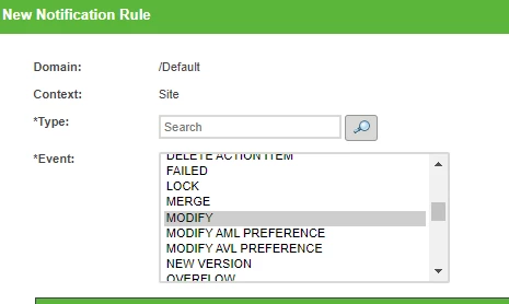

Hi @RFS
First I've never found a documentation that describes all events.
but you can start with Policy Administration in Notification Rules section.
In new rule you can find a list of existing rules and this is good start point.
PetrH

Mar 21, 2023 11:53 AM UTC
Great idea @HelesicPetr. It should be easy to test using this also. Since change objects are not iterated, I would see if Modify would thrown an event that the sync robot would catch. If you allow revise on change objects, there is New Version too. You will also need to have some code to see if its the right modification you are looking for. There could be modifications that you want to ignore so expect to catch too much but then filter then down to the one you are looking for. This is not unlike state changes where once you detect one, you check if its the droids you were looking for.
