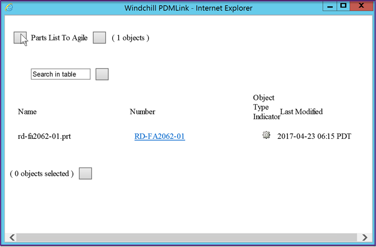

table is not displayed with proper table UI
I am trying to create a table UI on click on actions command on a popup page. Table is coming a plain page without table borders

Result is like this when I click on actions command,
Can someone help me to figure how to get the proper table here?
ShirishMorkhade
Jun 19, 2017 1:48 PM UTC
Hello Austin Nabors-Keating‌,
If I am not wrong, you are using Windchill 11.0 and Internet Explorer. Please try adding below line to JSP at the beginning:
<%@ include file="/netmarkets/jsp/components/beginWizard.jspf"%>
And below line to end of the JSP:
<%@ include file="/netmarkets/jsp/util/end.jspf"%>
I hope this helps you.
Shirish

Jan 23, 2020 1:31 PM UTC
Please include below file in JSP
<%@ include file="/netmarkets/jsp/util/begin.jspf"%>
