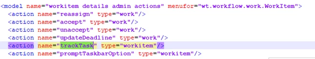

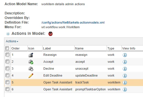

@DC_10584147  As I answered you in a older thread
just to be sure >D
I can see that there are some custom ext. actions.
It seams that the actionConfiguration xml file customActionModel.xml contains wrong definition for the Task assistant.
Check the OOTB actionModel definition and add the correct row to the customActionModel.
There can be naming change or something else between Windchill versions.
similar think happened to me if I just copy the customActionModel file from previous version to new one without any check, Some actions were missing because they change a internal name used in the XML.

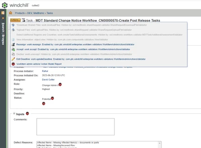

Hi @DC_10584147
Use jcaDebug=1 to see what validator hide the Task assistant action
CS30223 - How to use "jcaDebug"
I guess that you are not just in correct licence group
Also there can be some trouble with customActionModel.xml definition if you use old one from previous version.

Hi @HelesicPetr
jcaDebug doesn't show any validation issue, this due to Task Assistant not even listed.
I'll check the customActionModel.xml definition file.
just to be sure >D
here is example how the Task assistant definition looks like

3-Newcomer
Sep 12, 2023 1:59 PM UTC
Hello Charles,
The suggestion/feedback from @HelesicPetr provided the solution which addressed my issue.
Dave
